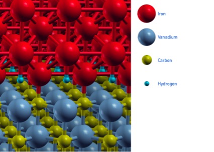

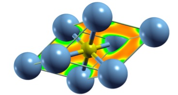

From the atomistic point of view, simulations are being carried out using a computational quantum mechanical modelling method called density functional theory (DFT), which is commonly used to investigate the electronic structure of many-body systems (fig. 2). More specifically, simulations are being done to evaluate the mechanical properties and the influence of hydrogen in a new experimental vanadium-containing bearing steel (fig. 3) in which hydrogen can be trapped to avoid embrittlement [3]. The results of the MultiHy project can help with the final development of this new steel, so that it can eventually be considered for applications where hydrogen resistance is needed.

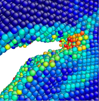

For this project, the molecular dynamics (MD) method is being used to study how the atoms move and interact with each other when a crack is initiating and propagating through bearing steel (fig. 4). The understanding of this phenomenon will enable SKF to find ways to increase the life and overall per-formance of SKF products.

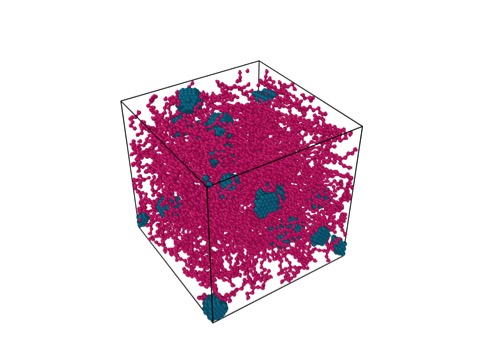

Dissipative particle dynamics (DPD), a meso-scale simulation tool that enables analysis of the dynamic properties of fluids and polymers (fig. 5) at scales that go beyond those that can be treated using MD, is used here. By employing DPD, the effect of various factors, such as the interaction between filler particles and polymer chains and the topological changes in the polymer network in the static and dynamic mechanical behaviour of sealing materials, can be fully considered.
