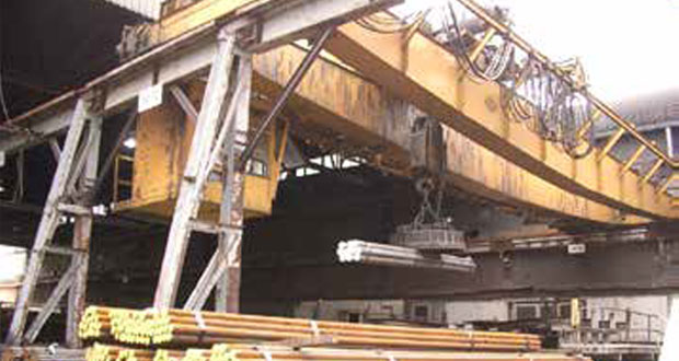

Jernberg Industries currently has one outside P&H yard crane built in 1948 to unload their 8-ton steel bundles from flat steel trucks. This crane typically operates 24 hrs / 7 days a week even in the harsh Midwest weather conditions. It travels approximately ¼ mile from the steel receiving area to the holding area and will move 1,000 tons of steel per day.
Challenge
With such a heavy work load, this crane was losing a wheel bearing per month, which cost Jernberg about 8-hours of downtime and nearly $6,000 to fix the bearing. This also caused a significant backlog in the receiving area and in most cases stopped the production line.
