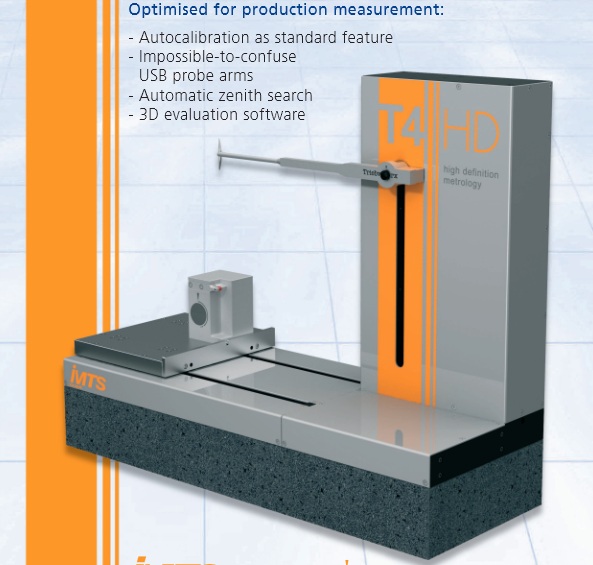

High definition metrology:
– Contour and roughness measuring with highest accuracy in the range of 200 x 20mm (X, Z) and 20 mm (Y)
– Optimized for production measurement
– Auto calibration as standard feature
– Impossible-to-confuse USB probe arms
– Automatic zenith search in X and Y direction
– Unobstructed view to drillings and measurement assembly
– 3D error compensation for double probe-tip measurements
– Durable and servo-free probe force switching
– 3D evaluation software for contour and roughness
– Speed-optimized repeated CNC measurements
– USB 4-axis CNC control for maximum flexibility of PC applications
– Form-fitting HD probe tips
– Probe-tip visualization
– 24“16:9 full HD monitor
– Expansion port as standard for optional 4th CNC axis
– High measurement resolution and accuracy
– Very easy to operate for the user
– Wide range of possibilities for administrators and qualified personnel
– Roughness measurement according to the standards with super-silent, low-resonance X and Z drive, according to DIN EN ISO 4287:2010-07, DIN EN ISO 4288:1998-04, DIN EN ISO 11562:1998-09, DIN EN ISO 13565-1:1998-04, DIN EN ISO 13565-2:1998-04
– 3D CNC axes X/Y/Z as standard
– Up to 100 multi contour measurements in one 4-axis CNC sequence
– T4HD enables optional mobile battery operation with laptop connection
– Flexible evaluation software for atomized, reproducible contour and roughness measurements even with rotated parts
– Dimensions: 592 x 492 x 220 mm (W x H x D)
– Weight: 45 kg
– Table load capacity: 25 kg
