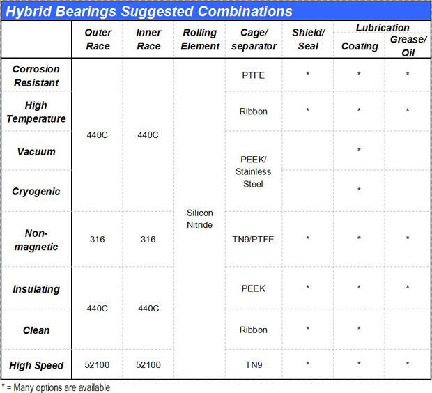

Here are a few common hybrid bearing configurations:
Figure 1: A table of hybrid bearing suggested combinations
All suggestions are subject to each individual application and are for comparative use only, in order to suggest the correct specification please contact one of our Engineers.

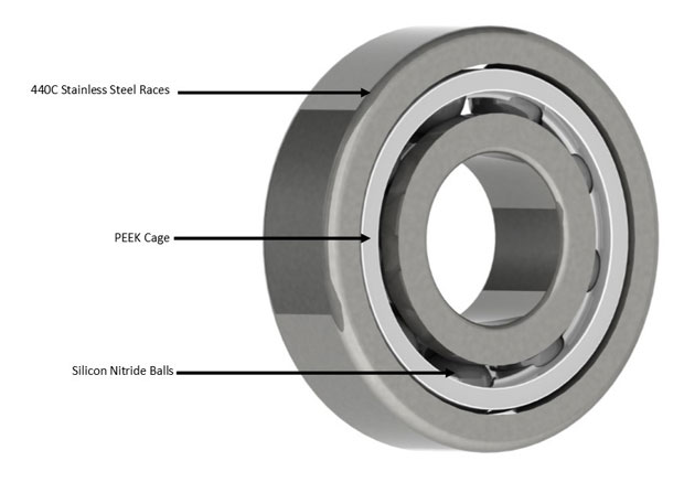

Figure 2: CAD render of hybrid angular contact bearing for a cryogenic pump

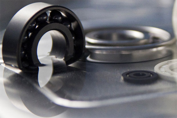

Figure 3: Examples of hybrid and ceramic bearings

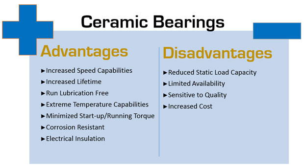

Disadvantages
- Reduced Static Load Capacity
- Due to the brittle characteristics of ceramic materials, the static load capacity is reduced by about 30% from the conventional steel equivalent while the dynamic load rating remains the same.
- Limited Availability
- Hybrid bearings are highly specialized bearings and because of this, the supply chain is minimal. It is important to have a trustworthy supplier with a large investment in high quality stock such as Carter Manufacturing Limited.
- Sensitive to Quality
- Ceramics, as a material, are brittle and therefore sensitive to cracks, flaws and contamination from manufacturing. Manufacturing ceramic balls requires technical expertise and rigorous quality control. It is important to know that your hybrid bearings come from a reputable source to prevent premature failure.
- Cater Manufacturing Limited is the European master distributor for Napoleon Engineering Services, the premium manufacturer of custom hybrid bearings from the USA which run small volumes with full aerospace certification AS9100 for flight critical bearings.
- Increased Cost
- Hybrid bearings are more expensive than their standard steel bearing equivalents. However, in general, they are much cheaper than ceramic bearings. Carter is a highly competitive supplier that doesn’t compromise on availability, quality or technical expertise.
 Figure 4: A table of the advantages and disadvantages of hybrid bearings
