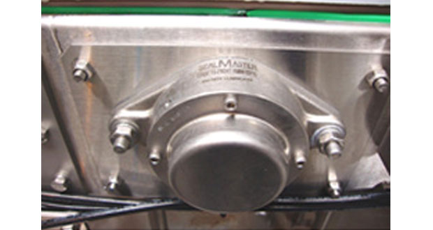

The added protection of end caps and backside shields can significantly prolong the life of a sealed bearing in clean-in-place and steam-in-place applications.
