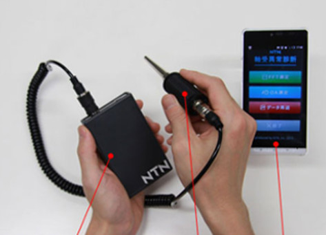

NTN Corporation has applied the bearing diagnosis technology that it has developed over many years to develop the “Handheld Diagnostic Device for Bearings” with outstanding portability.
The “Handheld Diagnostic Device for Bearings” developed by NTN utilizes a smartphone to send vibration data via the internet to a server for calculation and analysis. The input and output is also displayed on the smartphone, which makes for an extremely compact and portable vibration measurement system.

| (1) | Vibration data is sent to a server from the customer’s smartphone, and then calculated and analyzed on the server | |
| ? | Vibration measurement system with outstanding portability (AD converter: Height 100mm × width 60 mm × thickness 20 mm) | |
| (2) | Proprietary bearing diagnosis and identification by using FFT analysis | |
| ? | Determine proper or malfunctioning operation of bearings, identify worn areas if bearing is malfunctioning | |
| (3) | Measurement results saved on the NTN server | |
| ? | Measurement results displayed as graph, condition monitoring of equipment also possible | |
