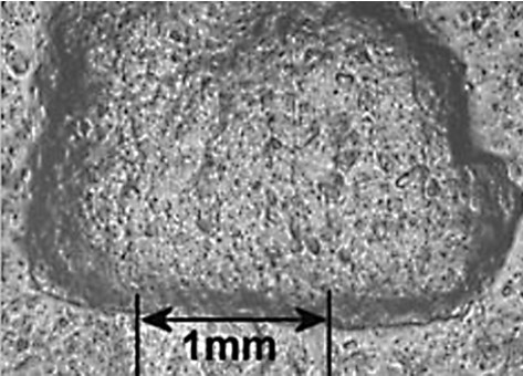

Nixon and Cogdell developed a method for assessing the detrimental effect of debris contaminated lubrication environments [6] which is appropriately labeled Debris Signature AnalysisSM. The following ?eld study, conducted in cooperation with an equipment manufacturer, is an example of the advantage that such a surface characterization method might provide in evaluating equipment systems. The standard method for determining particle size distributions and concentration levels was used to monitor contamination levels in an actual customer ?eld application. Bearings from these ?eld units were then removed from service after an extended period of time and examined for debris damage both visually and by the surface characterization method in order to quantify the damage levels. Table 1 shows a few typical particle size distributions and concentrations observed through the period of service by the equipment. Figure 1 shows a typical visual appearance of some of the bearing load carrying surface after the same period of service.
FIGURE 1 – Micrograph of typical bearing load carrying surface with extremely large dent
It was quite evident in just these visual comparisons alone that the lubricant analysis did not illustrate the level of surface damage that might be expected. By a comparison of the data in Table 1 to the damage evident by the visual appearance, it is certain that the lubricant sampling did not predict any particles much greater than 300 um in size. However, the visual comparison of dents, some on the order of 6 mm in diameter, indicates the presence of huge particles on the order of 100 times larger than the 300 um size particle from the lubricant sample. The Debris Signature AnalysisSM method was used to more accurately characterize the surface damage and indicated a 42% life reduction would be predicted. This example serves to illustrate the need for surface characterization in linking performance to contamination damage.
