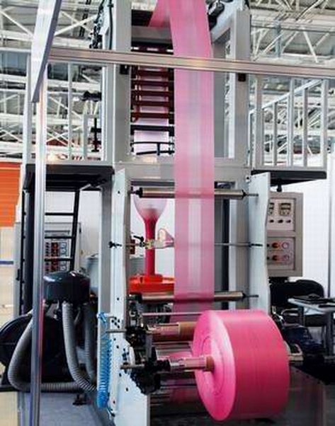

Fig. 3: Extrusion plant: source Fotolia_popov48
Good machine alignment, and roll alignment in particular, is essential to achieve maximum efficiency of the production in the packaging industry. With modern production machines running faster with larger working widths, this has even become a key requirement. The rise in speed and working widths increases the risk of folds and the production of rejects.
