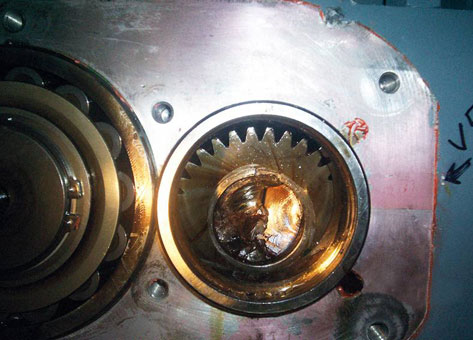

In a power plant drive system, inexplicable gear tooth damage occurred in a
gearbox. Based on systematic damage analyses, the occurrence of overloads
was suspected. Torque measurements were conducted to determine whether
the start-up or switching processes in the pole-changing motors were responsible.
Fig. 9: View of the measurement location on the gear side
Figure 9 shows a view of the measurement location near the gearbox. In the torque signals, three torsional natural frequencies can be identified. A soft starter was retrofitted to reduce the excessive amplitude of the first torsional natural frequency directly after start-up.
