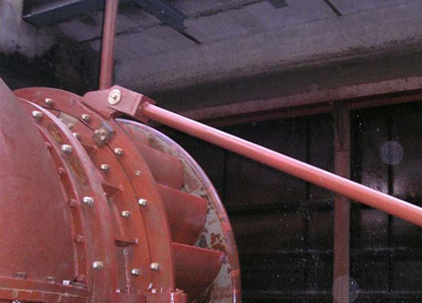

Fig. 1: The water tank had to be drained to enable impact tests in the wet area.

The only possible remaining source of vibration was natural vibrations arising from the hydroelectric unit itself. The question therefore was: Which components of this complex structure were responding to the natural frequencies? To find out, impact tests were made. First, possible vibration exciters were looked for in the dry area. Because none of the components were sensitive to vibration in the frequency range in question, the wet area of the hydroelectric unit had to be drained to be able to enter the unit. In the course of the search for the 190-Hz excitation, various impact tests were performed on the guide vane apparatus, guide equipment, blades, etc.
