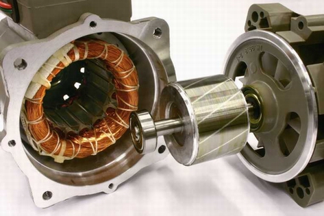

Built on standards established by the Energy Policy Act of 1992 (EPAct), the Energy Independence and Security Act (EISA) authorized the U.S. Department of Energy to set minimum efficiency standards for certain motor classes. Additionally, motors that were previously regulated by the EPAct were required to meet premium-efficiency standards established by the National Electric Manufacturers Association (NEMA) and motors that were not previously regulated were also given energy efficiency requirments.
NEMA Premium® Motors, made of more copper and higher-grade steel than lower-grade motors, can produce efficiency gains of up to 3% when compared with EPAct motors and up to 8% when compared to standard efficiency motors. While the initial costs of NEMA Premium® Motors are steeper than others, they can drastically reduce operating costs and have reduced total costs of ownership, often paying back the difference in less than two years. Additionally, longer life, quieter operation, increased warranty periods, and greater application versatility are other benefits that can be achieved by purchasing a NEMA Premium® Motor. Moreover, most of these systems can fit into previous envelopes, allowing for direct replacement of old equipment.
