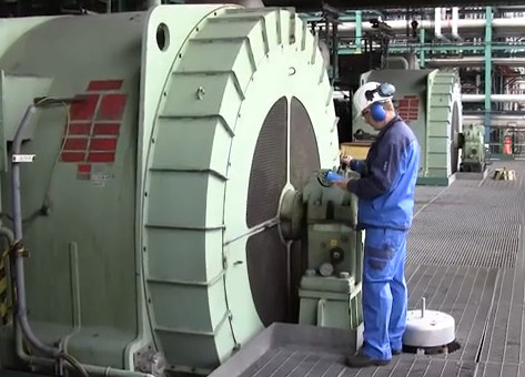

USING ULTRASOUND FOR MONITORING PLAIN BEARINGS
In recent years, improvements to instrumentation and software have challenged the concept of ultrasound applications as ONLY a simple inspection tool for leak detection. Many successful reliability teams have adopted ultrasound as an important tool for condition monitoring and predictive maintenance. Monitoring rolling contact bearings and acoustic assisted lubrication are performed daily using ultrasound. This has freed up valuable time for vibration analysts to focus on assessing critical assets first identified by ultrasound as being in a problematic state.
Plain bearings are widely used in turbo machinery and many other types of machines in the plant. Different to rolling contact bearings that enter a starved lubrication condition slowly and, therefore, are easier to trend, plain bearing lubrication requires a steady fluid film to work. Any situation that alters this oil flow leads to almost instantaneous contact-to-contact metal. Therefore, the window to failure for plain bearings is much smaller than it is for rolling contact bearings.
The data gleaned from monitoring plain bearings with ultrasound has some differences compared to rolling contact bearings. These differences are shown in Table 1.
HEALTH ASSESSMENT BASED ON STATIC ULTRASONIC DATA
There are three primary failure modes that are identifiable by trending static ultrasound data and analyzing dynamic ultrasound data. In order to easily visualize the different positions of the journal inside the bearing, imagine the bearing as a clock with a clockwise rotation (see Figure 2). With a well lubricated, normal plain bearing, as the journal rotates, the pressure effect of the oil wedge moves the journal towards 7 o’clock. The highest static ultrasound data should be expected at this point. Inspectors have to think in two dimensions now. Following a line at the 7 o’clock point position, several static readings are taken across the face of the bearing. All should be similar. An ultrasonic data collector with very good sensitivity is required because friction levels are low. The acoustic impedance of the shell and inner liner affect the acoustic energy reaching the contact sensor. The ultrasonic crest factor (CF) should be low. Crest factor is a numerical value that describes the ratio between the root mean square (RMS) value and peak decibel micro volt (dBuV). This is a condition indicator that provides insight for inspectors. CF allows them to differentiate between friction and impacting as the cause for high static values. Readings taken at 12 o’clock and 3 o’clock positions should be lower than seven. The time wave trace should be uniform without many spikes of energy.
