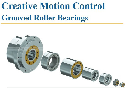

Creative Motion Control of Bellevue, WA has released a line of bearings that will set a completely new standard in high precision bearing performance: the patented Grooved Roller Bearing™ (GRB™).
Due to its revolutionary design, the Grooved Roller Bearing dramatically increases the load capacity, and therefore the life expectancy of comparably sized bearings. The GRB will last 5 to 15 times longer than the competition. This is accomplished by using grooved rollers which create many more contact points in the same physical space as shown in the diagram below. This provides either for dramatic reduction in the replacement cost and down time for an exact replacement or for a much smaller and lighter envelope for the same load capacity.

The Grooved Roller Bearing is available in thrust, radial or combination configurations. It is perfectly suited for roller screw or ball screw linear motion applications.
Exploded view of standard GRB
The GRB can also handle extremely high speeds (currently rated at 650,000 DN, and current testing is expected to prove speeds approaching 1,000,000 DN) such as those found in high speed spindle applications. Additionally, the alloy steel construction and the combo load capability provide excellent protection from catastrophic failure due to impact loads or unexpected radial loads.
35mm GRB
CMC is proud to offer the GRB in ABEC 5 and 7 tolerance compliant solutions. In addition, customizations, integrated flanges, specific preload requirements, odd/large sizes, and specialty applications are always welcome. CMC’s engineering team will work with you to find a solution that works for your unique needs. Lead times are extremely reasonable for all sizes, including custom and large sizes.
