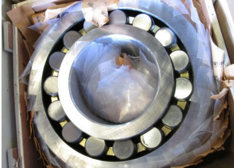

Planning for the pilot plant took place in the early months of 2011; construction began thereafter and the plant was accepted in China in February 2012. In November 2012, the system was set up in Dortmund – initially without peripheral equipment. In the first test runs of the system, there were already problems: after about 20 minutes, clearly audible knocking sounds occurred in the drive train even though it was only running at half speed.
The drive employs a 5 kW motor with a V-belt connection to the central vertical shaft. The maximum speed of the shaft is 750 rpm. One ball bearing supports it from below and two tapered roller bearings from above. The bearings also absorb axial loads. The initial assumption was that moving parts were coming into contact. The rotors were disassembled, but the knocking sound persisted. This meant that the drive itself had to be the cause, and it was also disassembled. But neither the process technicians nor the colleagues from the Department of Mechanical Engineering at the TU Dortmund could determine the cause of the knocking sounds.
Finally, the engineers removed the rolling bearings and attempted to contact the manufacturer, NSK. Based on the information provided, the first possible cause was considered to be a design error and tapered roller bearing tension. As a result, the design was adjusted and greater clearance was provided for the tapered roller bearings. But after the drive was reassembled and a test run carried out, no significant improvement was noticed.
When a test run of the drive without the centrifuge resulted in a temperature increase at the shaft of up to 80 °C after just an hour and a half and the shaft seized due to thermal expansion, the focus shifted to the quality of the upper tapered roller bearings, type HR 30322J.
After NSK received detailed images of the bearings, it was clear: all of the bearings were counterfeit and did not originate from NSK production. The counterfeiters had taken great pains with the appearance of the bearings; even the company logotype looked deceptively authentic. The best way to tell the difference between the original and the counterfeit was the processing quality of individual bearing components.
No more increases in temperature with original bearings of higher quality
New bearings were ordered from an NSK Authorised Distributor and then installed. Test runs demonstrated that the temperature of the bearings and the shaft remained below ambient temperature, even after nine hours in continuous operation, because the original bearings feature significantly higher quality in both material and processing. Now the drive cooling was able to function properly and there were no more knocking sounds. Moreover, the entire drive ran much more quietly than before.
