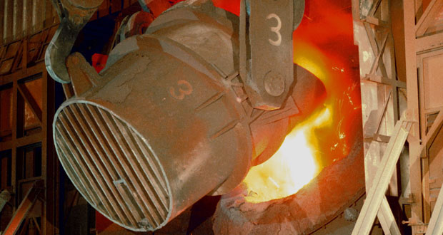

CAMBRIDGE, UK – May 2016 – MISTRAS Group Limited, the UK subsidiary of US based MISTRAS Group, Inc. (NYSE:MG) is monitoring the condition of low speed tilt bearings on Basic Oxygen Steelmaking (BOS) plant vessels at a steel production plant. In doing so, MISTRAS is providing valuable support to the customer helping establish the condition of the vessel bearings. The objective of the monitoring was to, over time, trend the bearing condition, provide advanced information on the behaviour of the bearing during rotation and identify any acceleration in degradation rates of these critical, high value bearings.
The BOS plant uses two vessels that convert molten iron from the blast furnaces into steel. Each vessel weighs around 1,300 tonnes, supported on two, 1.75m diameter spherical roller (tilt) bearings. Each vessel is able to tilt to various angles up to 150° from the vertical during the process for charging and discharging purposes. The arduous duty generates high local contact loads, which over time, result in surface fretting, pitting and spalling of the race surfaces. Ultimately, if undetected, further degradation can result in roller fractures and consequent catastrophic failure of the tilt bearings.
As Kirill Svartsov, Applications Engineer at MISTRAS Group UK operations comments: “The delivery lead time for bearings of this magnitude can be as long as 12-18 months, with plant downtime for a planned BOS plant vessel bearing change requiring four weeks. The bearing cost per unit becomes almost insignificant in comparison to the overall production outage costs. To help predict when the bearings are likely to fail and therefore when bearing replacement should be scheduled, we were asked by the customer to monitor the condition of the bearings on one of its BOS plant vessels.”
In March 2015, MISTRAS installed its Sensor Highway Data Acquisition System and permanent Acoustic Emission (AE) sensors on two tilt bearings on the BOS plant vessel. During controlled vessel rotations performed by the customer’s engineers, MISTRAS online monitoring (OLM) engineers monitored the vessel bearings via remote connection from its Cambridge, UK office to the onsite data acquisition system.
Rather than monitor the tilt bearings during normal operation, MISTRAS assessed the condition of the bearings during controlled vessel rotations. Under normal vessel operating conditions, the bearings do not rotate through a full 360-degree of rotation – they rotate around 60-75 degrees in either direction (i.e. clockwise and anti-clockwise). This means the rollers directly underneath the bearings are constantly subjected to the high loads during normal operation while others remain unloaded. MISTRAS procedure assess the condition of the bearings as they were tilted through the full 360 degrees of rotation, so as to gather a more complete assessment of the condition of the bearings.
The vessel is rotated 10 times in the clockwise direction and five times in the anti-clockwise direction (360 degrees of the trunnion rotation). This enables the rollers to be re-distributed ensuring loading is not focused on one particular set of rollers. To ensure continuity the vessel is empty during the tests, rotations are started from the vertical position and are also conducted continuously with no stops.
