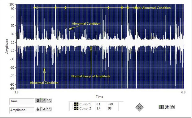

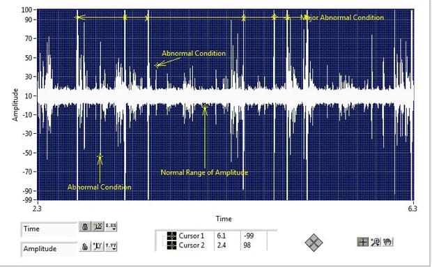

Slow speed bearing monitoring with ultrasound is actually easier than you might think. Because most high end ultrasound instruments have a wide sensitivity range and frequency tuning, it is possible to listen to the acoustic quality of the bearing, especially at slower speeds. In extreme slow speed bearing applications (usually less than 25rpm), the bearing will produce little to no ultrasonic noise. In that case, it is important to not only listen to the sound of the bearing, but more importantly to analyze the recorded ultrasound sound file in a spectrum analysis software, focusing on the time wave form to see if there are any anomalies present. If “crackling” or “popping” sounds are present, then there is some indication of a deformity occurring. In bearing speeds above 25rpm, it is possible to set a baseline decibel level and trend the associated decibel level readings over time.
Bad Bearing: 1 rpm bearing on a furnace application. Note all of the anomalies that appear in the Time Wave Form from the “crackling and popping” sounds that were produced by bearing fatigue.

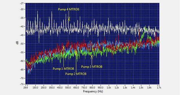

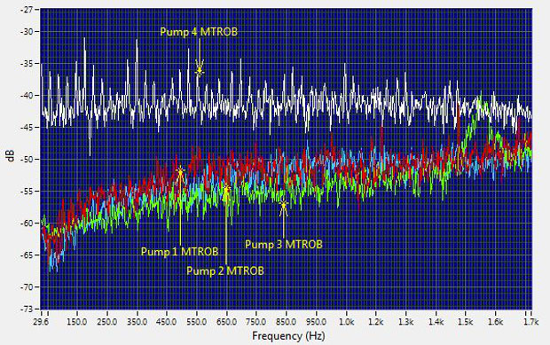

Once the baselines and alarm levels have been set, it is only necessary to record the data or dB readings. From that point forward, a sound file recording is only taken once the point has reached either the low alarm, or the high alarm. The alarm level sound file recording can then be compared to the original baseline sound file. This is important in diagnosing what the current bearing condition is. In a spectrum analysis software, technicians may also be able to compare the baseline sound file FFT to either the current sound file, or compare up to as many as four identical points on four identical machines.
FFT screen from an ultrasound spectrum analysis software that shows a comparison between motor outboard points on 4 identical motors. The Pump 4 Motor Outboard point shows an inner race fault harmonic.

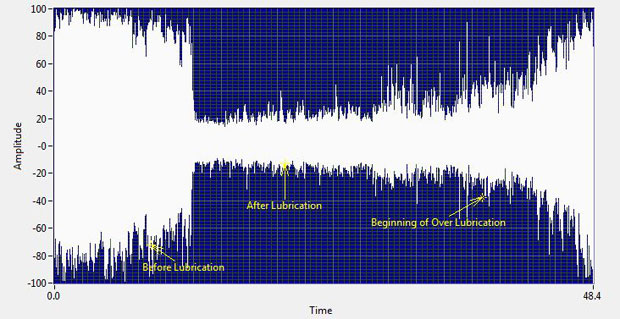

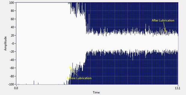

The concept is simple. It’s based off of friction. When a bearing is in need of lubrication, there is an increase in amplitude or the decibel level. If a technician is using ultrasound to listen to the bearing while greasing and watching the associated decibel level on the ultrasound instrument, if the bearing needs grease, there will be a gradual drop in the dB down to a more normal or baseline dB. At that point, the technician should stop lubricating. If the bearing is already sufficiently lubricated, the technician would start to see a gradual increase in the dB as grease is added. As more grease is added to an already sufficiently lubricated bearing, there is an increase in both pressure and friction inside the bearing housing; therefore, more noise. In this scenario, the technician should stop applying grease when an increase in dB is noted. If the technician is applying grease to a bearing, and there is no change in the dB, then a follow-up inspection with either recording the ultrasound sound file again, or a complimentary technology such as vibration analysis should be used to determine why the dB did not change during lubrication. If the bearing has physical damage, or is in a failure mode beyond a lack of lubrication, then there will be little to no change in the dB while greasing.
Time Wave Form view of a recorded ultrasound of a bearing properly lubricated. Note the amplitude before lubrication (left) and after lubrication (right).
Time Wave Form view of a recorded ultrasound of a bearing that has been over lubricated. Note the gradual rise in amplitude (right) as too much grease is added.
