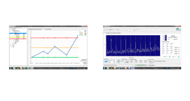

- Historical: Establish a trend over time of measured values with the help of DMS Software
- Analytical: Utilize Spectralyser software with the integrated bearing fault calculator
DMS, Data Management Software
With the Historical method & using the DMS Software we are able to also program alarm levels in our data points:
- Establish a baseline reading
- 1st alarm = indication of lack of lubrication
- 2nd alarm = early warning of bearing failure
After an upload of new data from a route, reporting functions in the software will help you to produce fast and easy a lubrication report.
